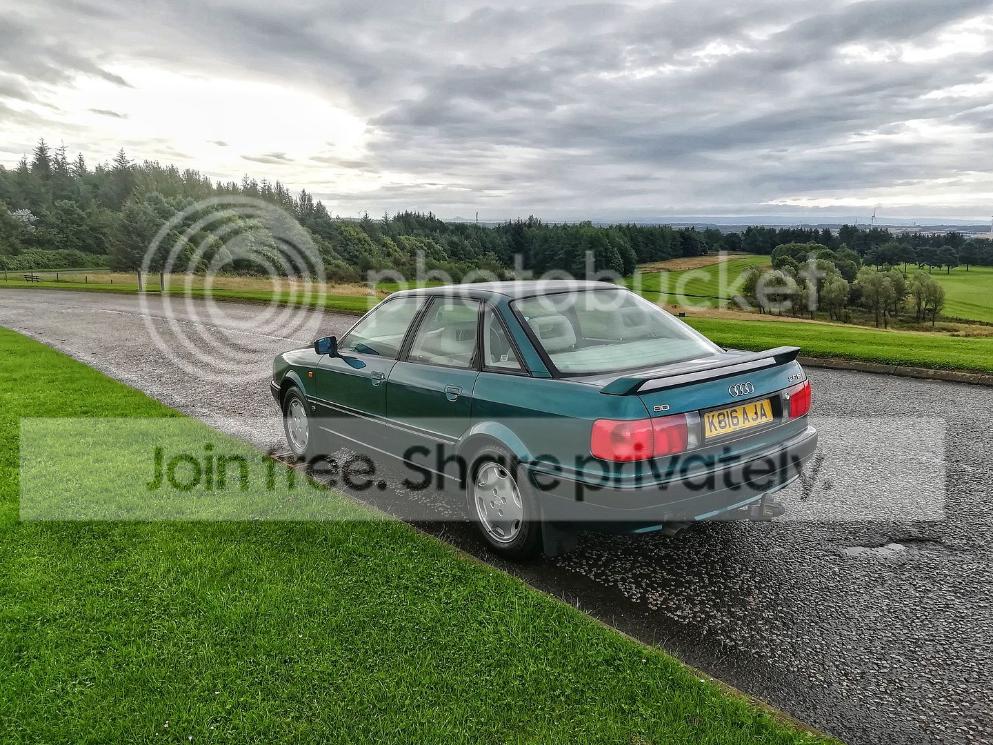

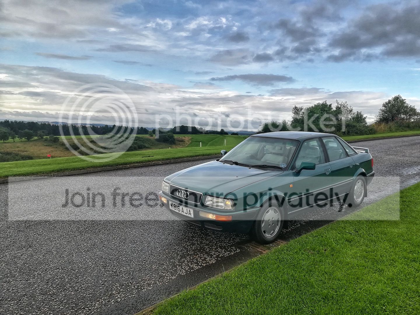

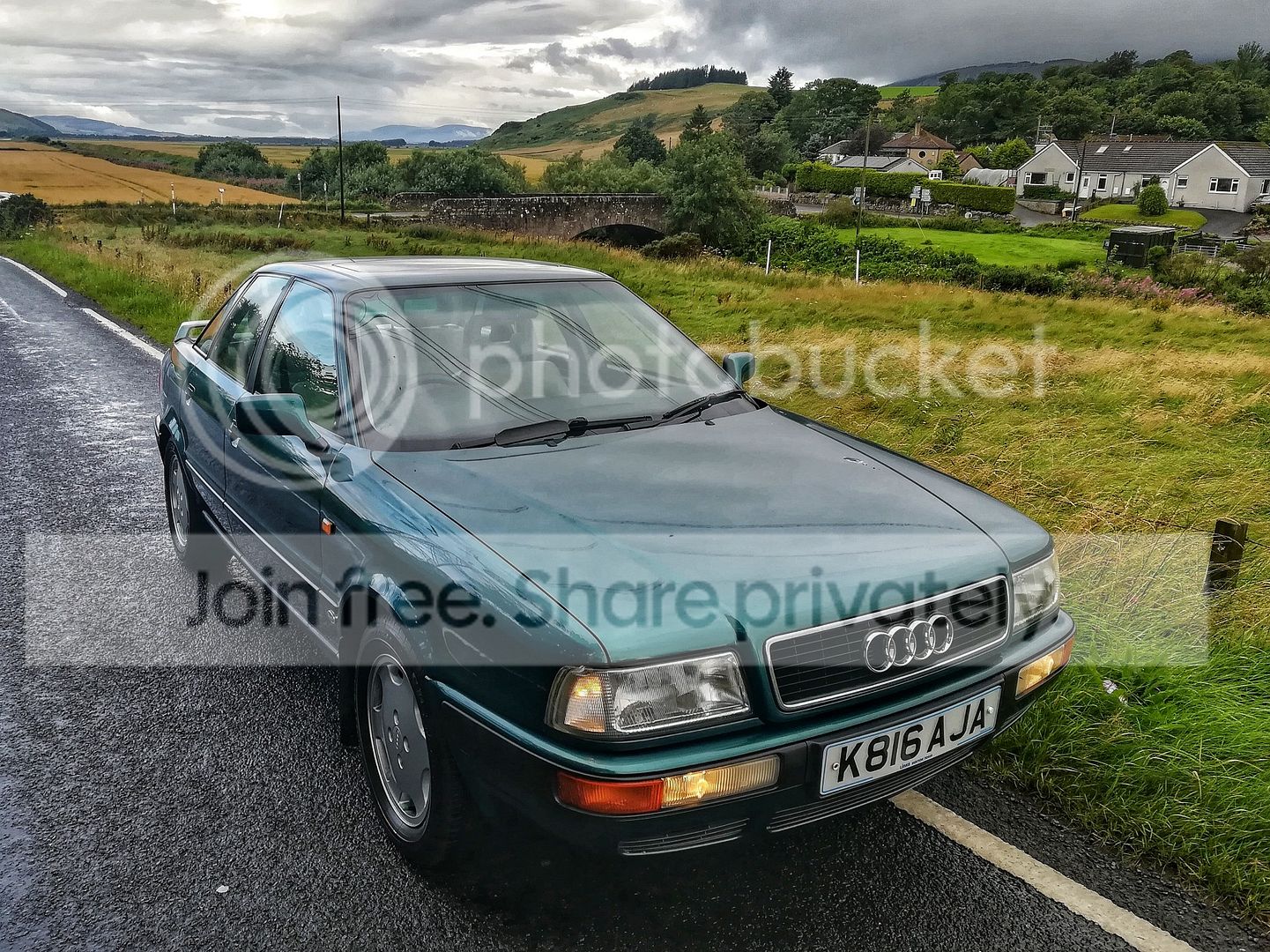

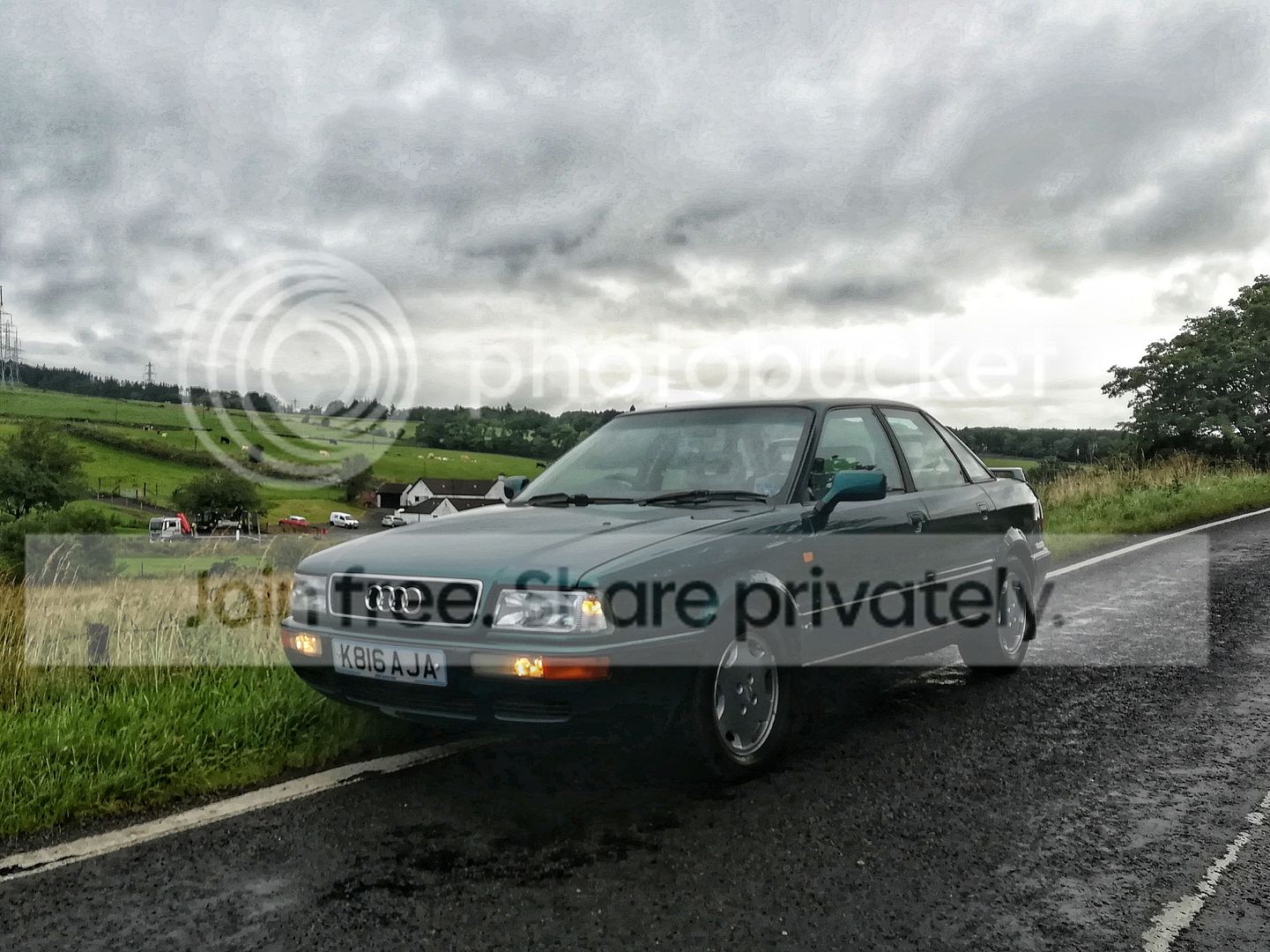

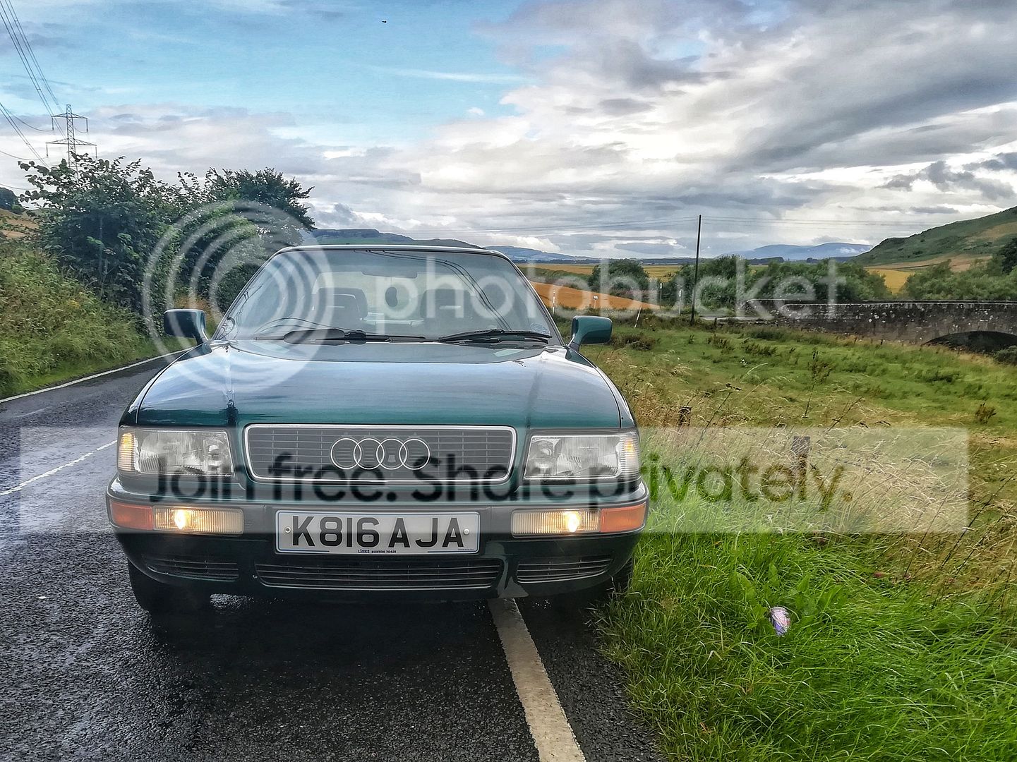

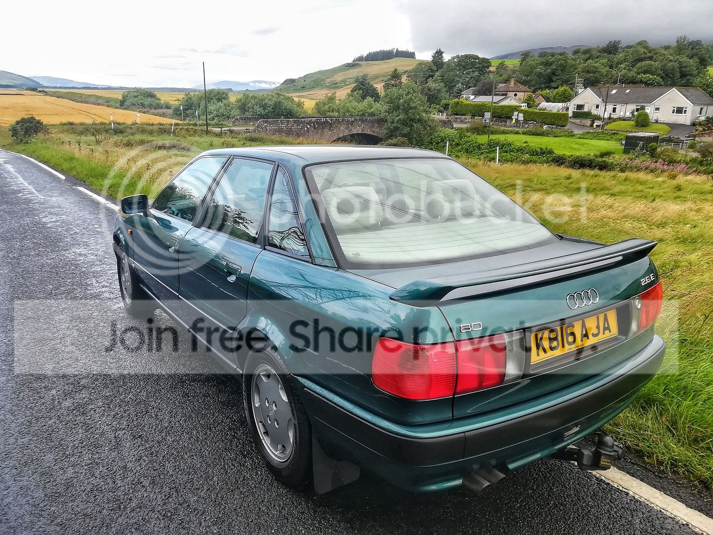

In the meantime, here are some photos taken on the way home from the garage this morning before the heavens opened.

Looks nice.

Looks nice.
Yeah, not bad at all....apart from some bird poo half way up the bonnet
Now removed
Alan67 is offline   Reply With Quote

Love the photos, the car looks great.
