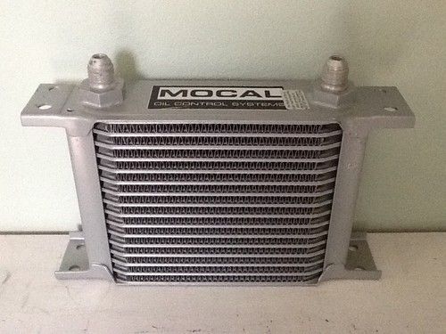

hi i just brought a oil cooler its a 16 row 115mm matrix Mocal pressed plate cooler 16 row 124mm high, 115mm matrix width 210mm overal, 51mm deep. with -6 JIC Male Fittings. what i need to know will the an6 fittings be big enough for the car and what size are the oil pump outlet fittings ?
its off my aby engine but i think it fits most audis

AN6 will be fine. Not sure what the fittings on the engine are, they will be metric.

M18x1.5 according to this thread
http://www.s2forum.com/forum/showthr...ght=oil+cooler
