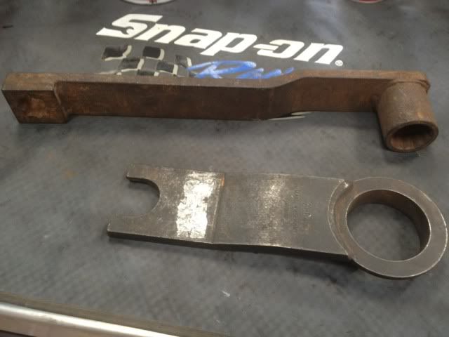

These should make timing belt change easier
