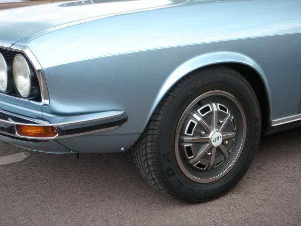

100Coupe's car has an interesting upgrade which is new slightly wider steel rims (6J I think) on original steel wheel centres which gives the wider track look whilst retaining the OEM look also. He had to extend the bolts holding the trims on though. Looks great in my opinion...

Standard Coupe (steel) wheels are 5" wide. Mine have 6" rims mounted on the original wheel centre, with the extra inch on the outside of the wheel. The wheel trims are fitted using spacers attached to the original wheel nuts. When I lowered the car, I aimed for 40mm, but not certain if I achieved that. Either way, I think it looks about right.
