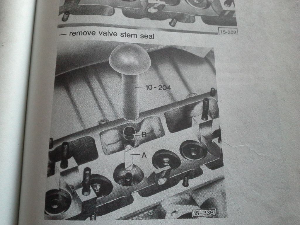

This I found in my bentley bible - page 15.25. The tool code is 10-204. Anyone have one?

Mostly a socket or a nut driver (10 or 11 mm) is good enough for that job. I do so since more than 30 years at numerous different vehicles.

Its £17 posted for the removal pliers and a installation tools for an ebay special.
http://www.ebay.co.uk/itm/Valve-Stem...item2589df63d3
Or just use a socket.
