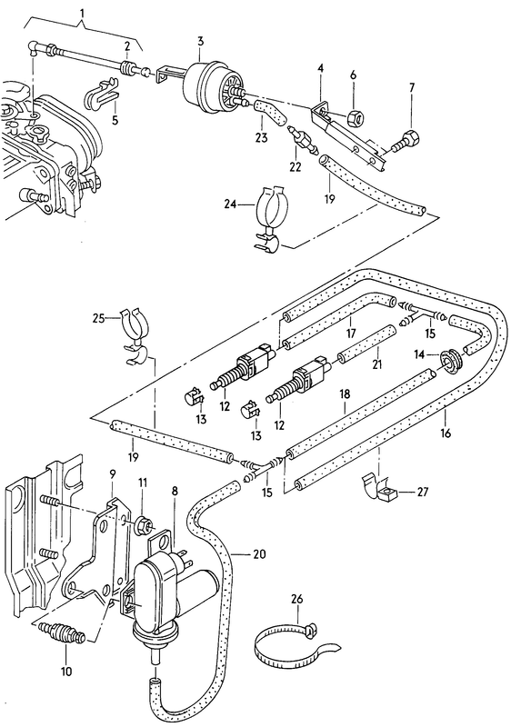

Column switch. I don’t remember which car, but the switch was loose. Just selecting the turn indicator was enough to trip the cruise.
Is it still vacuum? Broken hose connections, perished tubing.
https://audi.7zap.com/en/rdw/audi+a8.../9/907-907010/
Diagram for vacuum cruise is fairly simple
Pump, pedal switches, actuator.
I’d post the diagram, but Tapatalk doesn’t seem to be working anymore
7zap, diagram for 1999 A8 cruise control

You know i need to do a deeper dive into how the system works, I'm not sure if they run on vacuum like the 200 does, it may be electronic. I'm still very new to the workings of the A8 despite being a fan for years, it's only when you own one do you realise how complex they are.

I realise I wasn’t very clear, as I added that image after I’d posted.
That image is of the system from an A8.
