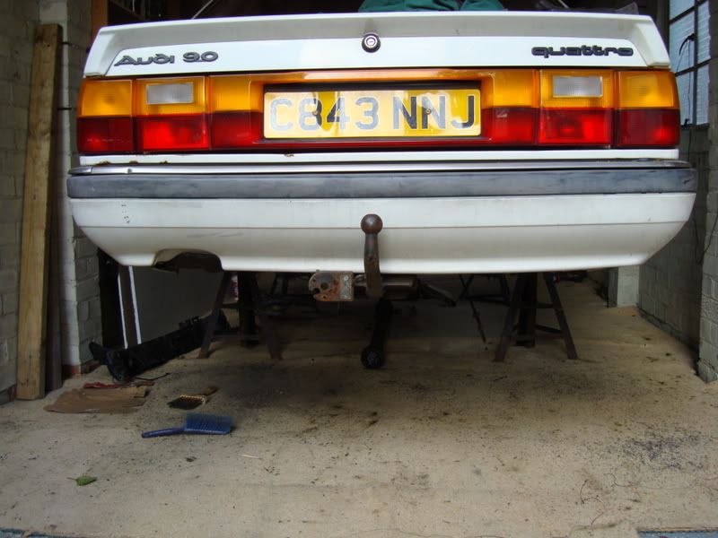

Here you go, I think the 80 & 90 will share the same tow bar set up.
Here in the bottom right hand side of the picture, you can see the setup of the tow bar. Basically the shape of the frame follows the contour of the boot floor and the back panel.

That won't help him - yours is quattro, while his 4000, being diesel, obviously is FWD.
IIRC FWD towbar is way simpler in construction - just pair of plates, with pair of holes for bolts in each, welded to the pipe.
P.S. Nice stuff in that picture. Did you fitted old anti rollbar or went through brake line conversation?

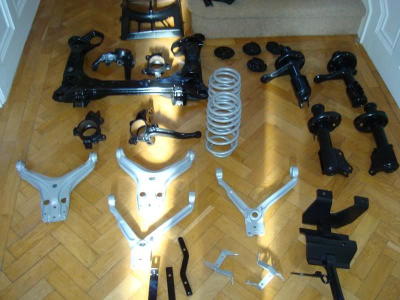

Forgot about his being fwd. But anyway if he does come across a tow bar, at least the picture wil help Driggs detrmine quattro or fwd..
Mine has complete S2 running gear.

Nice. I'm currently missing pair of B4 wishbones or left forged wishbone [some time ago I accidentally bought right one very cheaply] for full 2.8 front axle setup. It feels strange that if my car would have left factory 2 1/2 years later and fitted with 20v engine, I would be changing just front anti-rollbar, not everything except subframe
